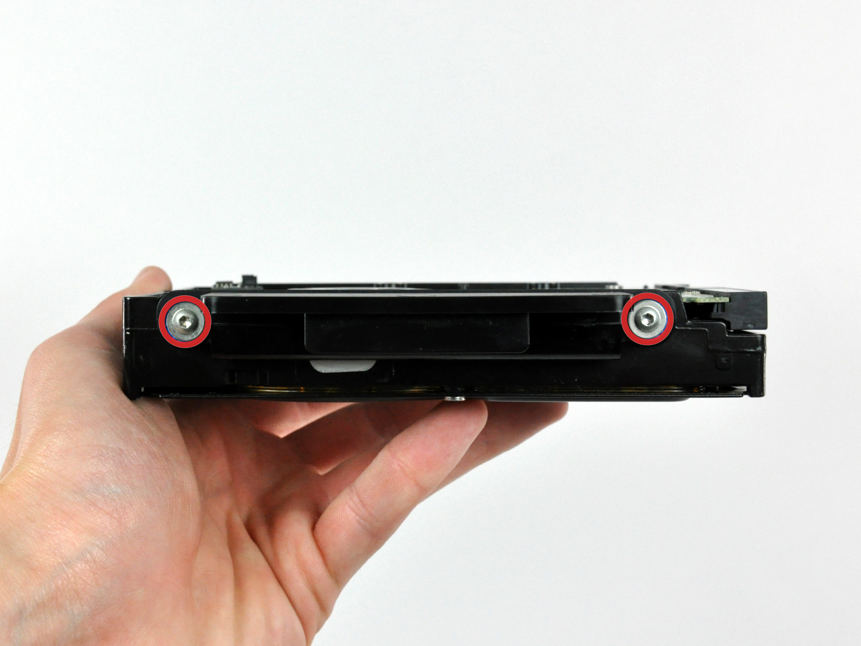

Add Note Edit Step 21  ¶
  • Remove the two T8 Torx pins on the connector side of the hard drive and transfer them to your new hard drive.
first image
