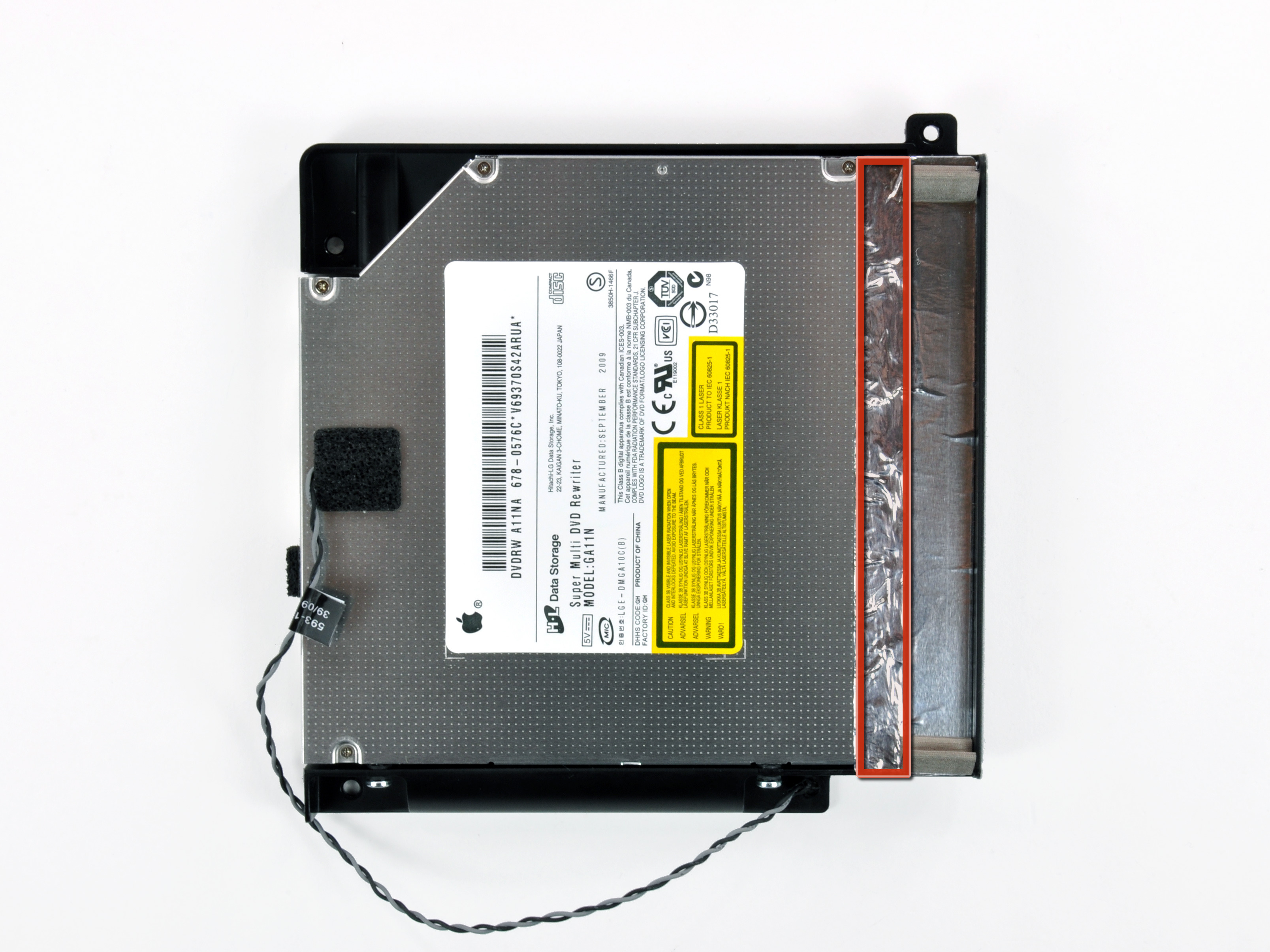

  14. iMac Intel 27" EMC 2309 and 2374 Optical Drive Replacement, Optical Drive: step 14, image 1 of 2 iMac Intel 27" EMC 2309 and 2374 Optical Drive Replacement, Optical Drive: step 14, image 2 of 2
    • Peel back the portion of aluminum tape highlighted in red, leaving the rest attached to the black plastic optical drive bracket.
    • It is not necessary to peel all of the EMI tape off the optical drive bracket.
