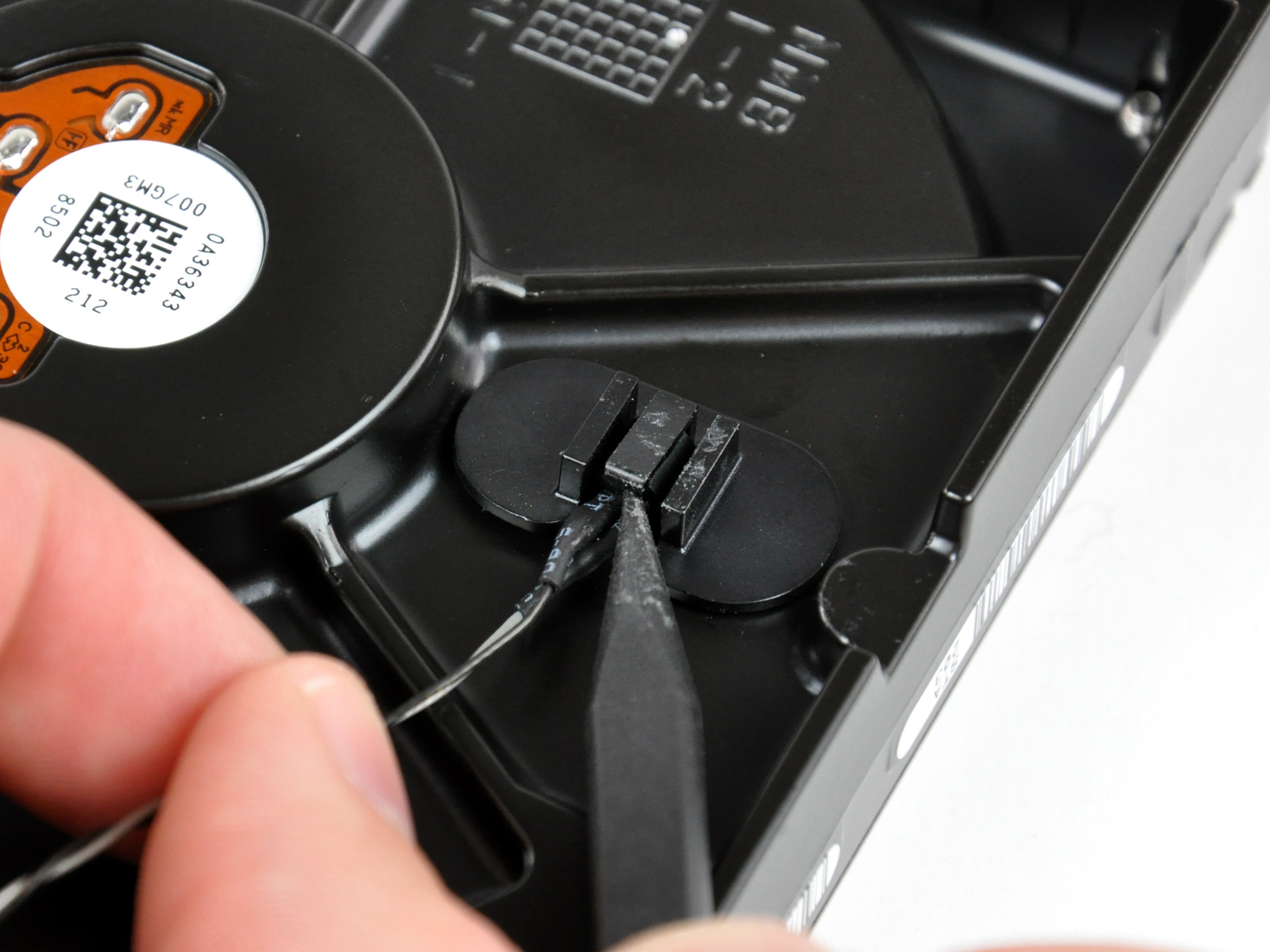

  20. iMac Intel 24" EMC 2267 Hard Drive Replacement: step 20, image 1 of 2 iMac Intel 24" EMC 2267 Hard Drive Replacement: step 20, image 2 of 2
    • To remove the hard drive thermal sensor, use the sharp end of a spudger to lift the center finger of the thermal sensor bracket while applying slight tension to the thermal sensor cable.
    • If the thermal sensor is stuck to the hard drive, skip to the next step.
  21. iMac Intel 24" EMC 2267 Hard Drive Replacement: step 21, image 1 of 1
    • Use the flat end of a spudger to pry the hard drive thermal sensor bracket up off the adhesive securing it to the hard drive.
    • If the adhesive gets dirty or will not stick to your new hard drive, place some double-sided tape under the two semicircular ears of the thermal sensor bracket.
