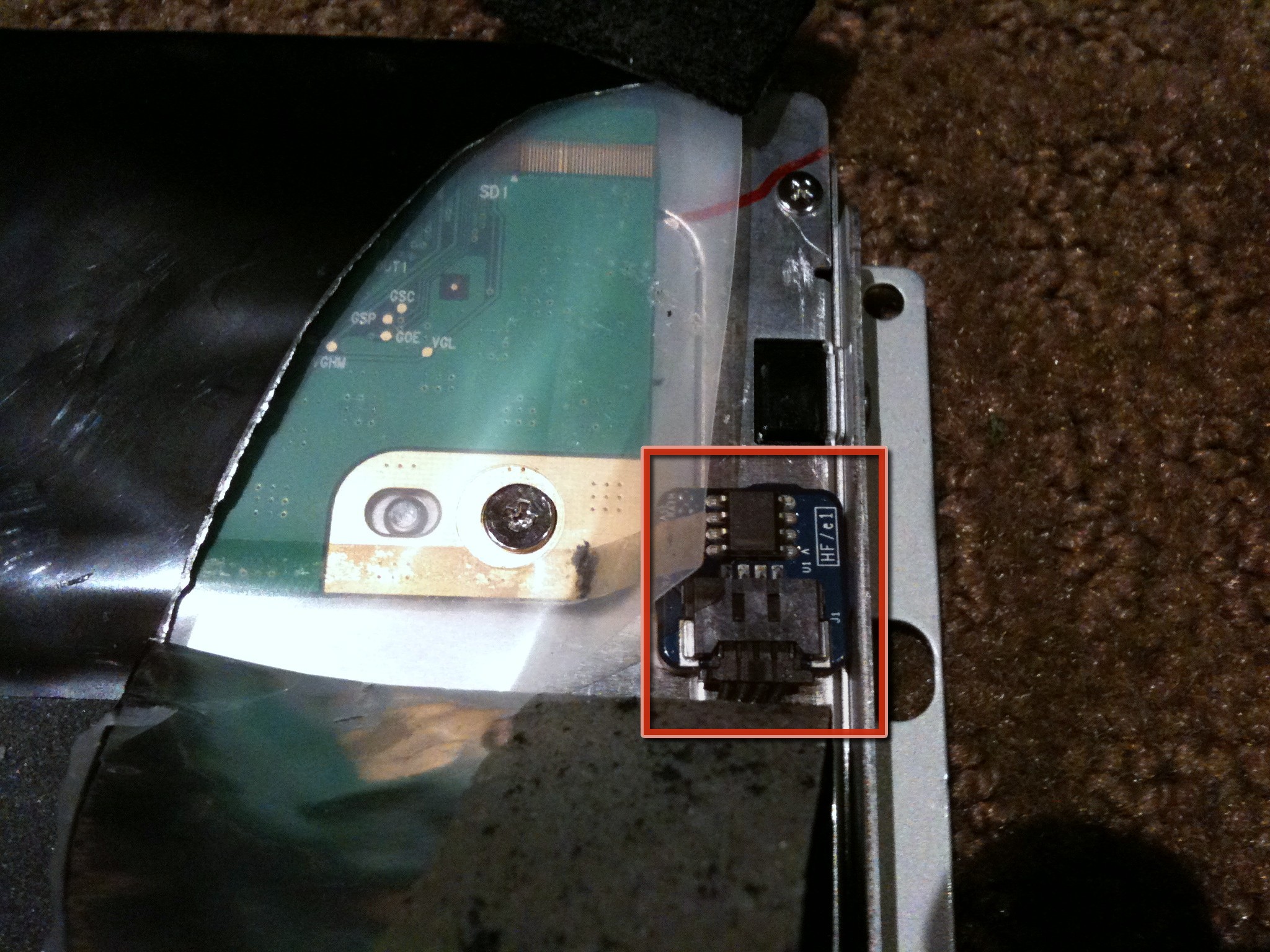

The purpose of this guide is to show where the LCD temperature sensor and cable are located so they can be replaced if necessary
Image #1
