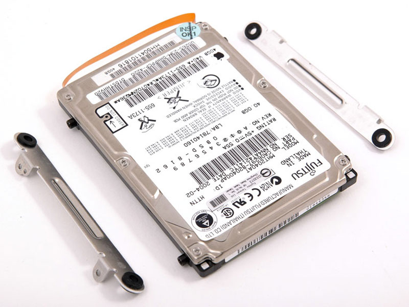

You can install hard drives up to 9.5mm thick.
