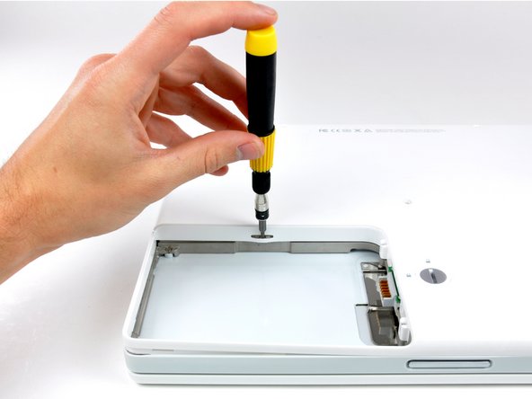

  • Use a coin to rotate the battery locking screw 90 degrees clockwise.
Image #1

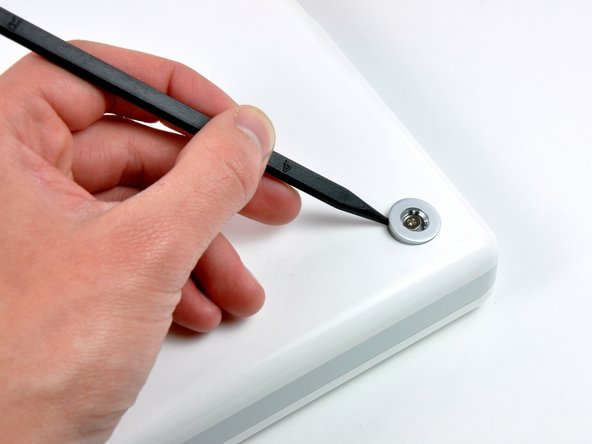

Add Note Edit Step 9  ¶
  • Use a spudger or small flathead screwdriver to pry up the three metal rings that housed the rubber bumpers.

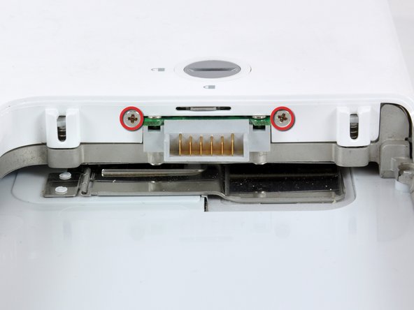

  • Remove the two Phillips screws on either side of the battery contacts.
Image #1

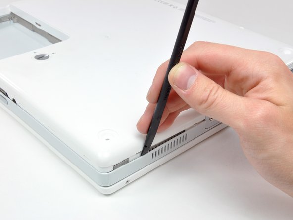

  • Run a spudger along the seam between the lower case and upper case on the front of the computer to free the tabs locking the lower case. Pull up on the lower case and continue to use the spudger as necessary until you hear three distinct clicks.
Image #1

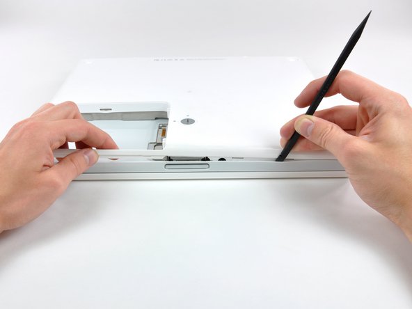

Add Note Edit Step 14  ¶
  • Continue to run the spudger around the front, right corner. There are two tabs on the port side of the computer, one near the front corner and one near the sound-out port.
Image #1
Add Note Edit Step 15  ¶

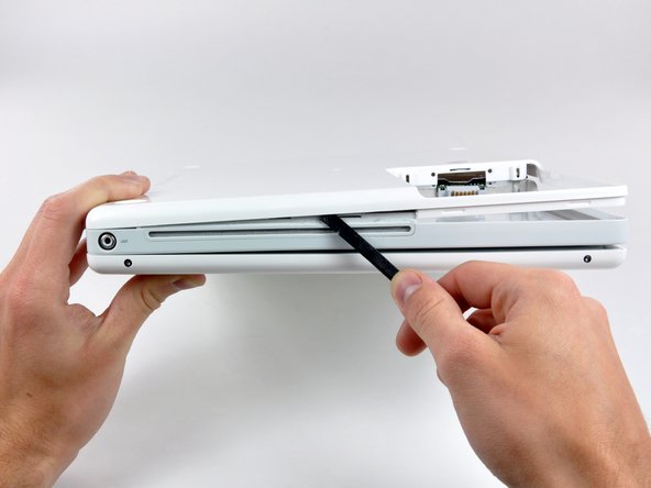

  • There are three tabs over the optical drive that must be released before the lower case can come off. Slide the spudger into the lower case above the optical drive and run it toward the back of the computer until you hear three distinct clicks.
Image #1
Add Note Edit Step 16  ¶
  • The front and sides of the lower case are now free.
  • Turn the computer so that the back is facing you and pull the lower case up and toward you until the back tabs pop free.
  • It may be helpful to jiggle the case up and down.
Image #1

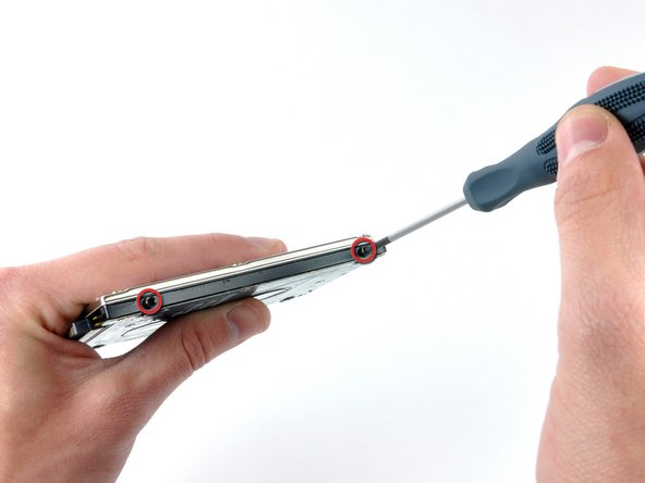

  • Remove the two black T8 Torx screws from either side of the hard drive (four screws total).
Image #1
