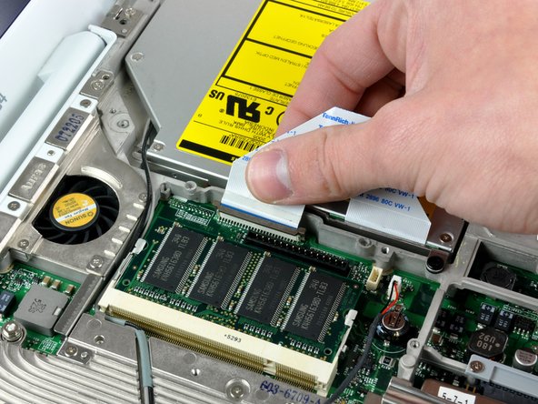

Add Note Edit Step 33  ¶
  • Release the optical drive ribbon clamp as described above. Slide the optical drive ribbon out of its connector.

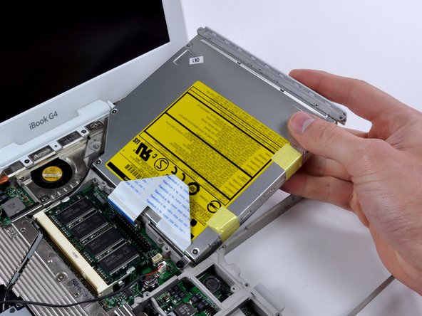

Add Note Edit Step 34  ¶
  • Lift the optical drive from the metal framework.

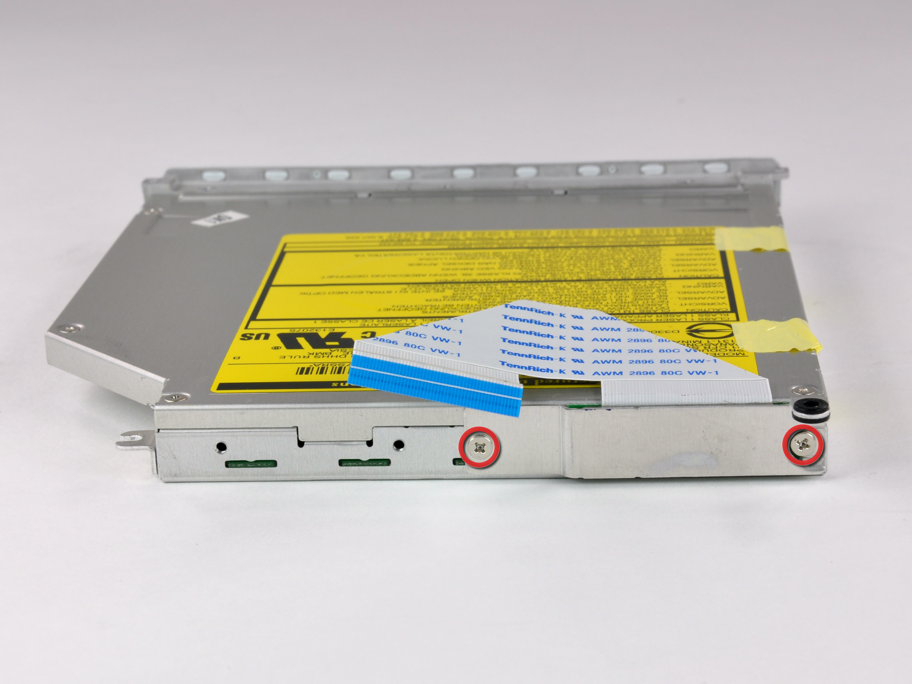

Add Note Edit Step 35 — Optical Drive Replacement  ¶
  • Remove the two Phillips screws securing the metal bracket and cable to the back of the optical drive.

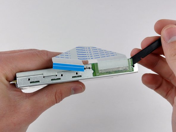

Add Note Edit Step 36  ¶
  • Use a spudger to pry the white optical drive cable connector up from the top of the optical drive, removing tape as necessary.

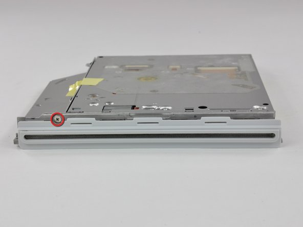

Add Note Edit Step 37  ¶
  • Remove the single Phillips screw securing the bezel at the front of the optical drive.
  • This screw is longer than the two that secure the bracket and cable at the back of the drive.

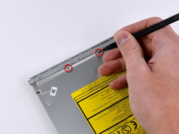

Add Note Edit Step 38  ¶
  • The bezel has several small, fragile tabs that will break easily.
  • Use a spudger to carefully depress the two tabs on top of the bezel.
