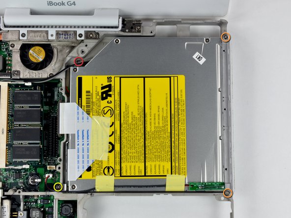

Add Note Edit Step 30 — Optical Drive  ¶
  • Remove the following 4 screws:
    • One 3 mm Phillips in the channel between the optical drive and fan.
    • Two 6 mm Phillips from the upper and bottom end of the drive bezel.
    • One 6 mm Phillips with a collar from bracket extending from the lower left corner of the drive.
Image #1

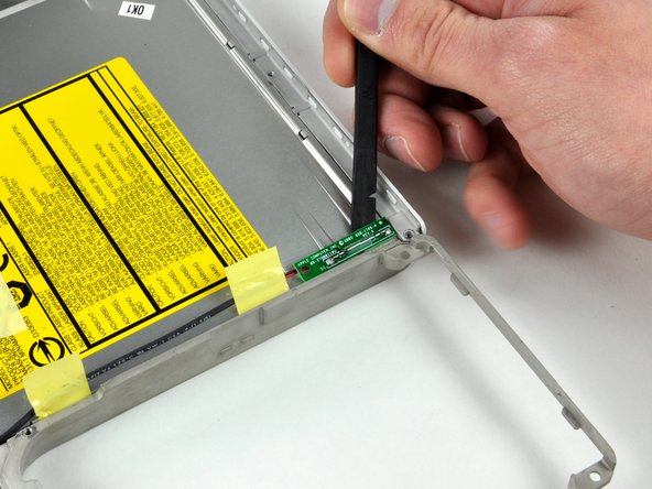

Add Note Edit Step 31  ¶
  • Use a spudger to pry up the Reed Switch Board from the optical drive, removing tape as necessary.
Image #1

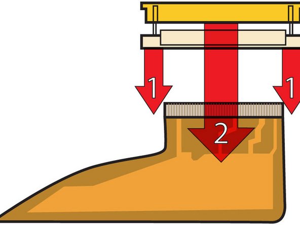

Add Note Edit Step 35 — Optical Drive Replacement  ¶
  • Remove the two Phillips screws securing the metal bracket and cable to the back of the optical drive.
Image #1
