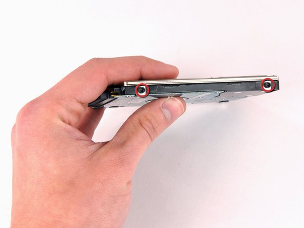

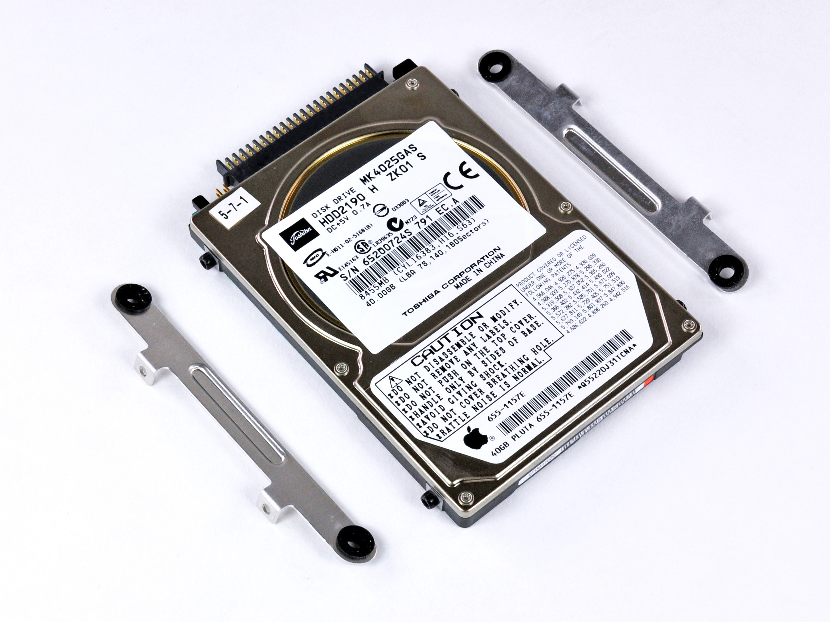

  • Remove the hard drive brackets from the left and right sides of the hard drive.
Image #1
Add Note Edit Step 34  ¶
  • Remove the two black T8 Torx screws from either side of the hard drive (four screws total).
Image #1
Add Note Edit Step 35  ¶
  • Pull the plastic hard drive connector straight away from the hard drive.
  • This is a bit tricky. Try rocking the connector gently while pulling with even pressure. If you bend the pins, do your best to straighten them, using the hard drive connector as a guide.
  • Hard drive remains.
