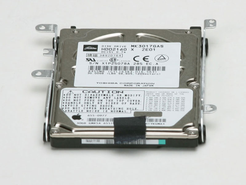

Add Note Edit Step 38 — Hard Drive  ¶
  • Your laptop should look approximately like this.
Image #1
Add Note Edit Step 39  ¶
  • Use the transparent orange loop to disconnect the large orange ribbon cable from the logic board.
Image #1
Add Note Edit Step 40  ¶
  • Lift up the front edge of the hard drive.
  • Peel back the black tape to free the microphone cable from the hard drive.
Image #1
Add Note Edit Step 41  ¶
  • Use the transparent orange loop to disconnect the hard drive ribbon cable from the hard drive.
  • This is a bit tricky. Try rocking the cable gently from side to side while applying even pressure. If you bend the pins, do your best to straighten them, using the hard drive cable as a guide.
Image #1
Add Note Edit Step 42  ¶
Image #1
Add Note Edit Step 43 — Hard Drive Replacement  ¶
  • Your hard drive should look approximately like this.
Image #1
Add Note Edit Step 44  ¶
  • Remove the metal brackets from either side of the hard drive (if they're still there).
  • With the pins facing away from you, and the label facing up, the bracket with a tab in the middle and a metal slot on it goes on the left side of the drive; the other bracket, of course, goes on the right.
  • Remove two T8 Torx screws from either side of the hard drive (four screws total).
