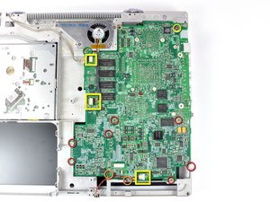

[* standard] Close the display and flip the computer over.
[* standard] Remove the following 8 screws:
[* red] FiveEight 3.5 mm Phillips.
[* orange] OneTwo 3.5 mm Phillips near the sleep light connector.
[* yellow] One 3.5 mm Phillips with a large head in the lower left corner.
[* green] One 4.5 mm Phillips.
[* black] DisconnectFrom top to bottom, disconnect the inverter and sleep light cables from the logic board.
[* black] Disconnect the inverter
inverter, fan, and sleep light cables from the logic board.
