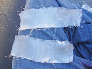

| [* black] Cut out pieces of fiberglass large enough to cover the damaged area and extend at least 1" beyond the repair area. Multiple layers can be used to add strength and rigidity. |
