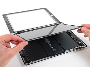

| [* black] Lift the LCD from its long edge closest to the volume buttons and rotate it out of the rear case. |
| [* black] Lay the LCD on the front panel as seen in the second picture. |
