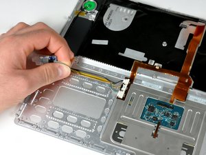

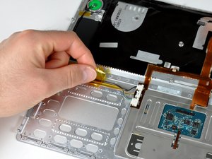

[* standard] Insert wisdom herePeel up the orange tape covering the Bluetooth data cable.
[* standard] Peel up the Bluetooth data cable from the adhesive on the upper case.

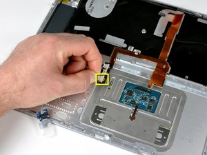

[* black] Disconnect the Bluetooth data cable from the upper case.
[* standard] Lift the Bluetooth board and attached cable off the upper case
