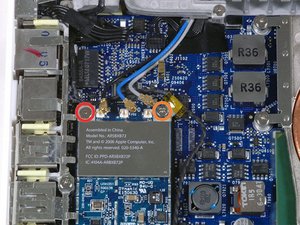

| [* black] Remove the following 2 screws from the Airport card: |
| [* red] One 3 mm Phillips from the left side. |
| [* orange] One 8 mm Phillips from the right side. |

Image 1 (added)
