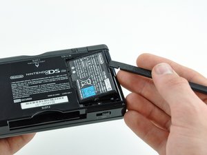

| [* black] Wedge the edge of a spudger in between the side of the battery and its lower case housing and pry upwards to dislodge the battery. |
| [* black] Remove the battery from the DS Lite. |
