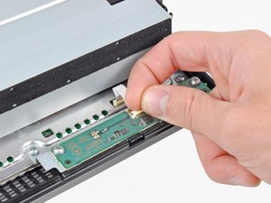

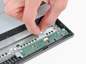

| [* black] Use your fingernail to flip up the retaining flap on the control board ribbon cable socket. |
| [* icon_caution] Be sure you are prying up on the retaining flap, '''not''' the socket itself. |
| [* black] Pull the control board ribbon cable out of its socket. |
