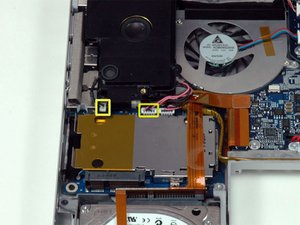

| [* black] Disconnect the pink and black left speaker assembly cable from the left I/O board. Be sure to pull only on the white connector and not on the speaker wires. |
| [* black] Disconnect the microphone cable connector from the left I/O board. |
