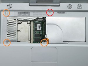

| [* black] Remove the following 4 screws on the edges of the keyboard area. |
| [* red] One 4.5 mm Phillips underneath where the magnet was. |
| [* orange] Three 6 mm Phillips in plastic depressions. |

Image 1 (added)
