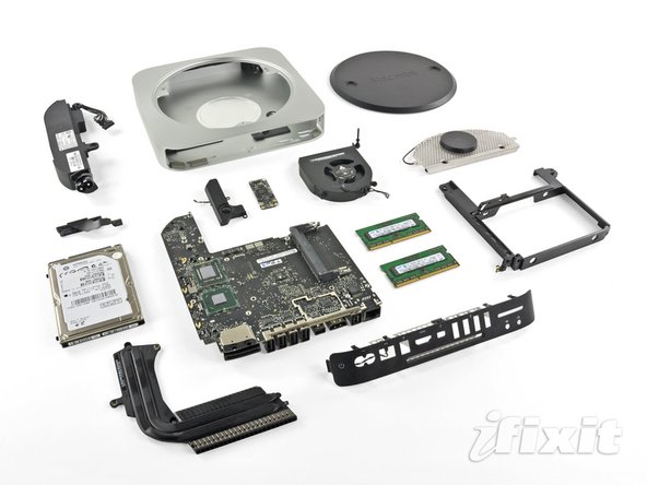

We find ourselves in possession of a brand new Mac Mini with promise of "2x faster everything" and the new Thunderbolt I/O. Naturally, we had to take a look inside, just like we did with the new MacBook Air earlier today.
Follow iFixit on Twitter for the latest updates.
Image #1
Step 1 — Mac Mini Mid 2011 Teardown  ¶
  • We received some big promises with the introduction of this new Mac Mini. The most exciting included:
    • Core i5 & i7 Processors
    • 500 & 750 GB HDD or 250 GB SSD
    • 2GB or 4GB DDR3 SDRAM
    • AMD Radeon HD graphics processor with 256MB of GDDR5 memory (2.5 GHz models only)
    • Thunderbolt and HDMI ports
    • SDXC card slot
  • Apple removed the optical drive from this Mini, but would characteristically love to sell you one for an additional $79.
Image #1 Image #2

  • Main ICs on the underside of the logic board:
    • Intel BD82HM65 Platform Controller Hub
    • Intel V116A068 2.3 GHz Dual-Core i5
    • Intersil ISL6364 Dual PWM Controller
    • Parade PS8171 HDMI/DVI Level Shifter
    • SMSC USB2513B USB 2.0 Hub Controller
    • AELTA 8904C-F
    • SMSC 1428-7 System Management Bus temperature sensor
Image #1
Step 14  ¶
  • Big players on the top side of the logic board include:
    • Intel L116IA35 Thunderbolt port controller IC, similar to that found on the Early 2011 21.5" iMac
    • Broadcom BCM57765 gigabit ethernet and memory card controller
    • Texas Instruments XIO2211 FireWire Controller
    • Cirrus Logic 4206B Audio Controller
Image #1 Image #2 Image #3

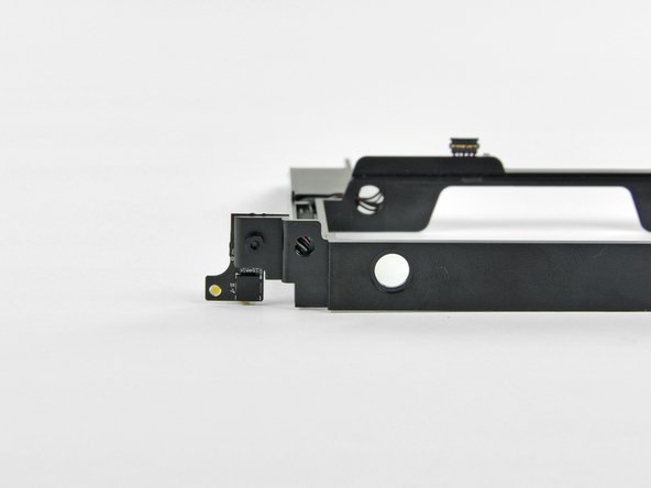

  • One more T6 screw and we can pull the IR sensor/receiver from the optical drive-- what? No optical drive? To make room for the additional hard drive option, Apple has removed the optical drive from this year's Mini and replaced it with some good old-fashioned emptiness.
  • The IR sensor stares straight into the depths of our souls. Sorry buddy, you won't find your lost optical drive here.
Image #1 Image #2
