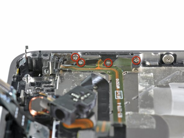

Remove the four 1.6 mm Phillips screws securing the volume button and silent switch brackets to the outer case.

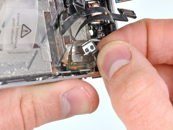

Gently pull the silent switch bracket away from the outer case and peel its small ribbon cable off the inside of the iPhone.

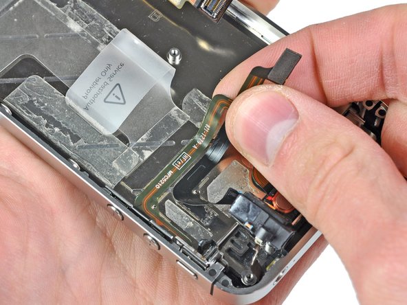

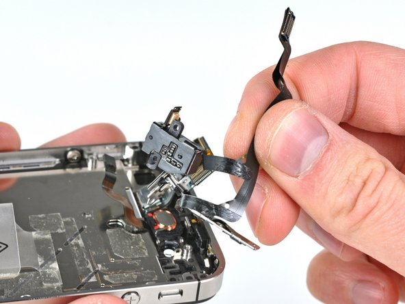

Remove the headphone jack cable from the iPhone.

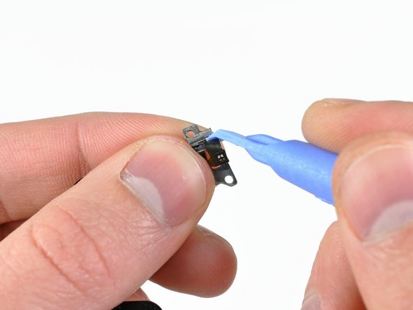

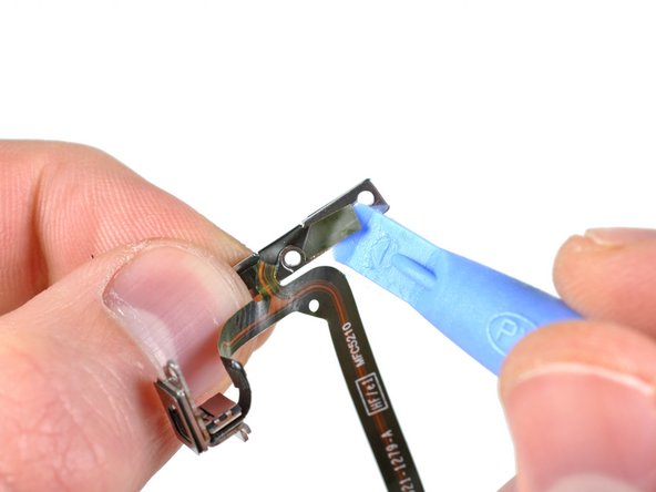

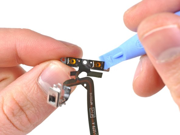

If you are replacing the headphone jack cable, use the edge of a plastic opening tool to remove the steel brackets for the volume buttons and the silent switch.
Transfer these steel brackets to the new headphone jack cable.
