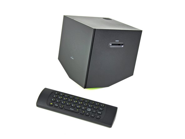

Step 1 — Boxee Box Teardown  ¶

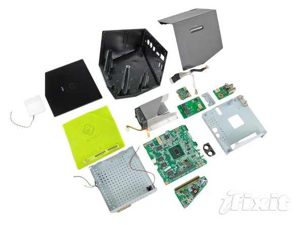

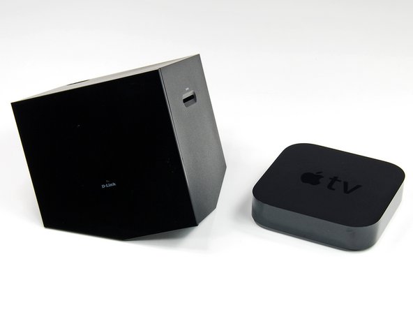

  • Ladies and gentlemen, iFixit is proud to present the Boxee Box by D-Link.
  • It's hard to ignore how much taller the Boxee Box is than the Apple TV and Logitech Revue. This half-sunken cube will definitely stand out in your entertainment system.
  • Yet, we feel that the Box has build quality that rivals Apple's, and is much more solid-looking than the Revue. The front panel is made of glass sturdy plastic and displays a Boxee logo once you power on the device.

  • The Boxee Box looks huge when compared to the Apple TV, but it's really not that cumbersome in real life -- the Apple TV is just teeny tiny.

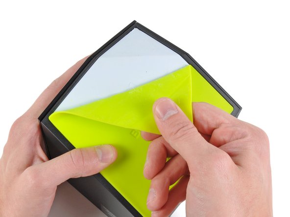

Step 3  ¶

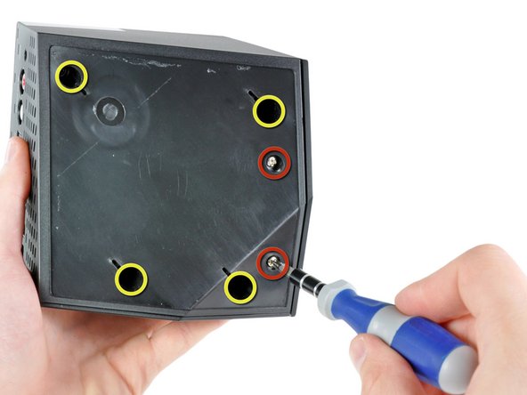

  • We had to peel off Boxee's lime-green rubber base and the adhesive sheet underneath to expose four #1 Phillips and two #2 Phillips screws.
  • The #2 Phillips screws are clearly visible when you peel off the rubber base.
  • The #1 Phillips are recessed, so you'll need a screwdriver with a longer shaft to access them.

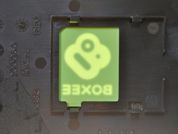

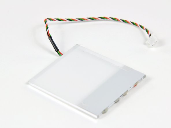

Step 6  ¶

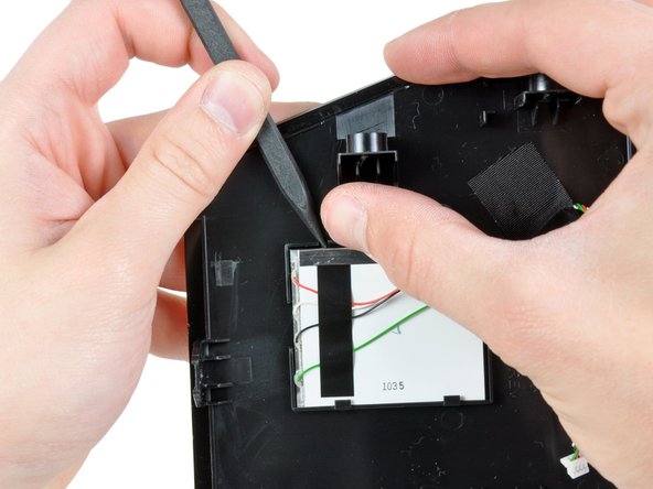

  • A little bit of prying and the status panel can be removed from the front panel.
  • A soft white plate on the status panel disperses the light from a couple LEDs to illuminate the semi-transparent Boxee logo either orange (standby) or green (running).
Image #1 Image #2 Image #3

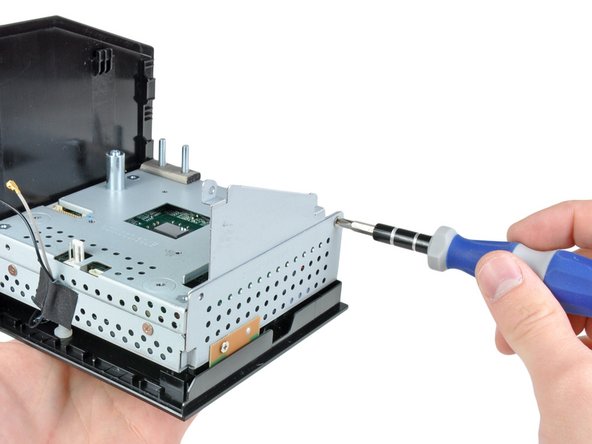

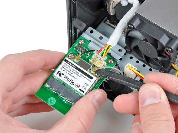

Step 7  ¶

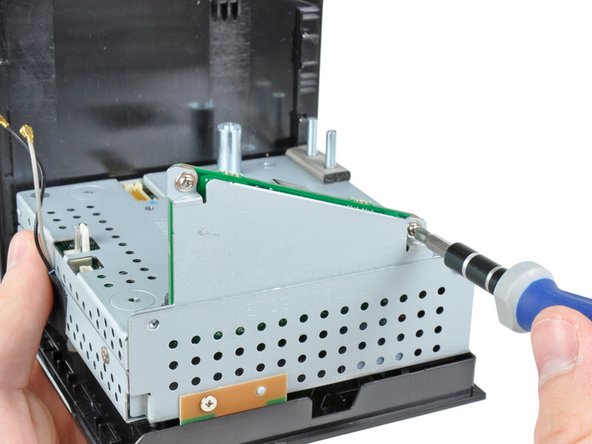

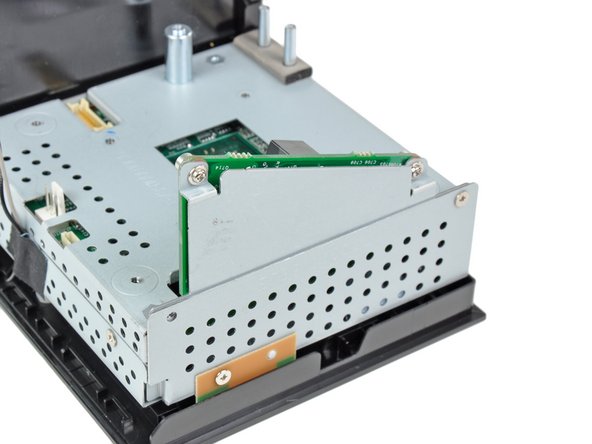

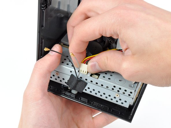

  • The Boxee Box' wireless board is secured to the metal frame by more Phillips screws.
    • It certainly is refreshing to see common screw types in electronics. When you don't need special tools to repair devices, it's easier to fix it yourself.
  • The wireless board is held on by a data connector and a couple antenna cables.

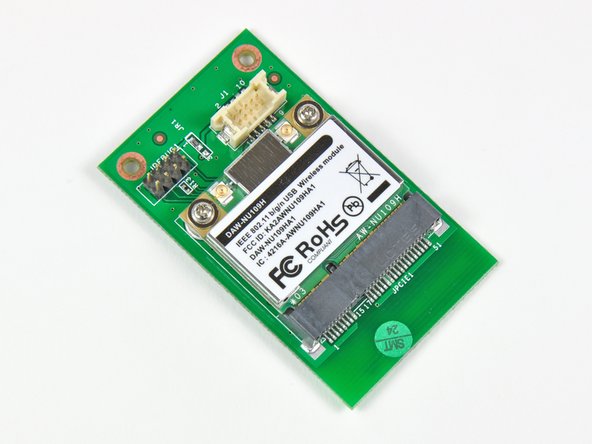

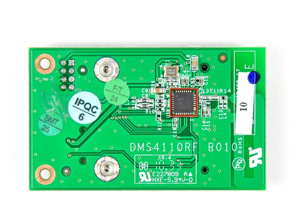

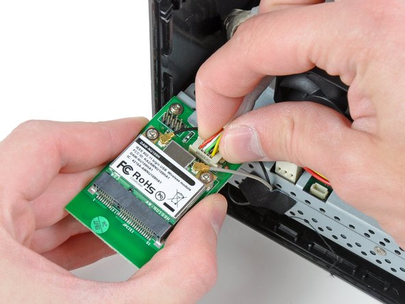

Step 8  ¶

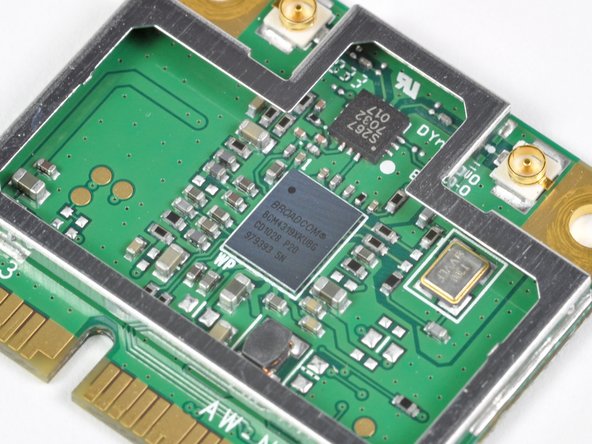

  • The wireless card assembly is composed of a Mini PCI-E wireless card and an interconnect board where the cable from the motherboard is connected.
  • On the back side of the interconnect board we found a Nordic Semiconductor NRF24LU1P transceiver.
    • This chip is most likely used to decode signals received from the awesome QWERTY wireless remote.
    • We recently found the same chip in the Boxee's direct competitor, the Logitech Revue.
  • The Mini PCI-E wireless card employs a Broadcom BCM4319XKUBG.
  • An remote control antenna is printed into the interconnect board right below the Mini PCI-E socket. This is positioned near the top of the device when it is assembled to aid in remote control reception.

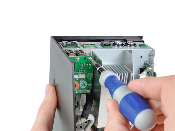

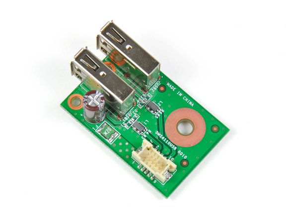

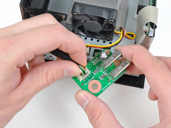

  • Next come the dual USB ports, which are mounted on a small PCB.
  • The PCB is connected by two #1 Phillips screws, as well as a connector that runs to the motherboard.
  • A thorough USB board analysis reveals a 220 μF capacitor, a PTC Fuse to protect against faulty USB devices, ESD Protection hardware (Clamp diodes and series inductors), and two USB sockets.

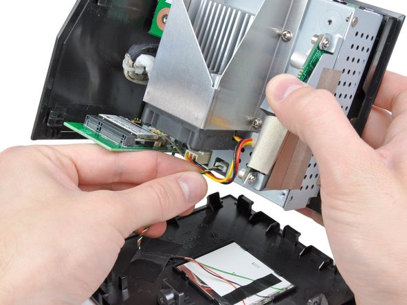

Step 10  ¶

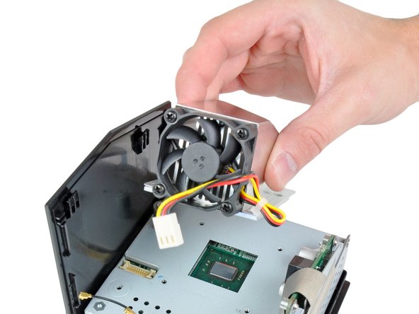

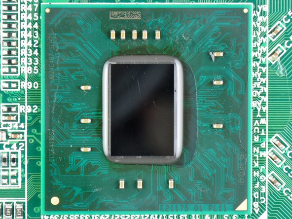

  • We progress by removing the fan and heatsink assembly from the CPU. It's time to find out what makes this baby tick.
  • Instead of using thermal paste, the Boxee Box uses a phase-change thermal pad much like the one found on the heat sink of the Logitech Revue.

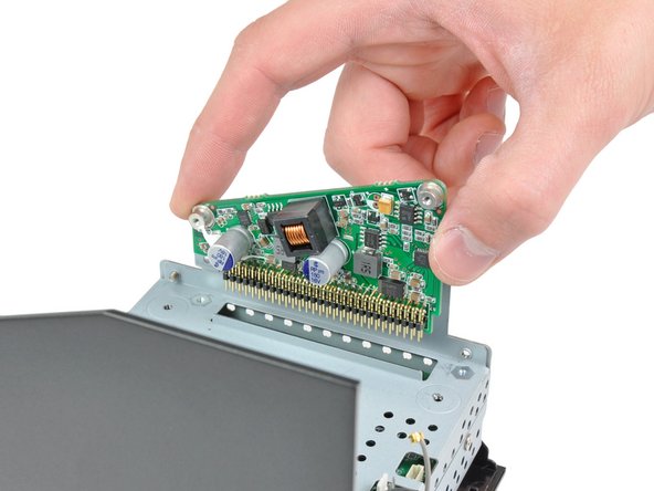

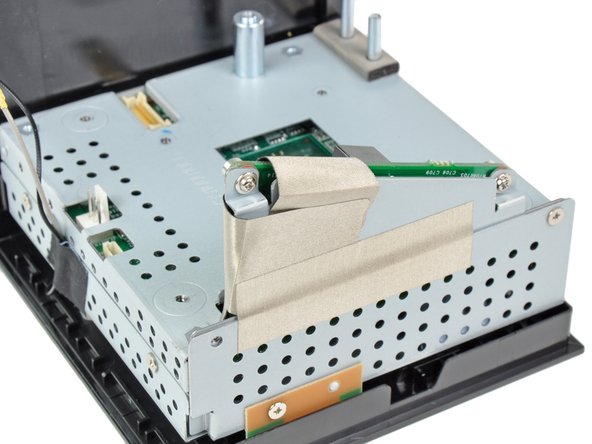

Step 11  ¶
  • A couple strips of EMI tape and a few more Phillips screws hold a very triangular power board in place.
  • The tape is most likely placed around the exposed circuits to eliminate audio interference from the power conversion process.
Image #1 Image #2

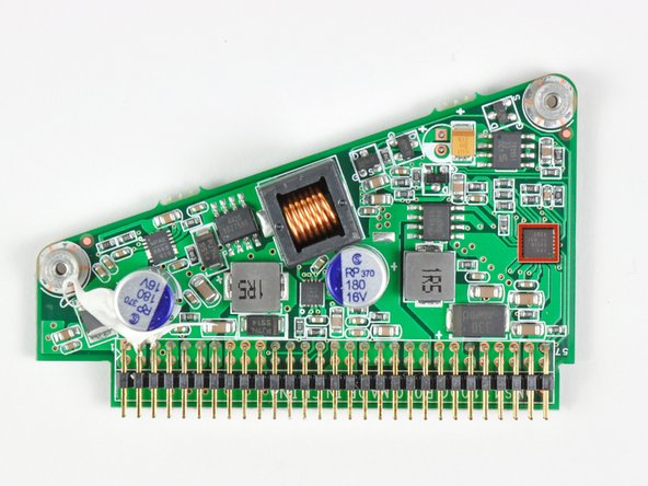

Step 12  ¶
  • What do you find inside of an oddly-shaped device? An oddly-shaped power board, of course.
  • On this board we find:
  • This board is most likely used to convert the 12V received from the power adapter into the voltages used by the motherboard and all the accessory boards.

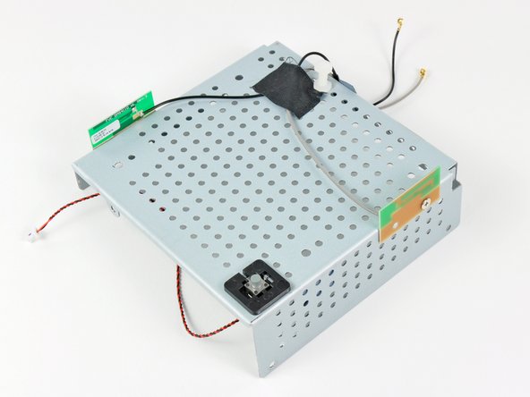

Step 13  ¶

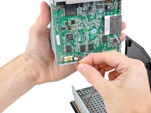

  • After removing a couple more Phillips screws, the motherboard can be removed from the rest of the metal frame.
  • Once it's lifted out, the power button connector is the only thing keeping us from getting a closer look at the board.
  • Once the motherboard is out, the bottom metal frame can be removed from the plastic outer casing.
    • The power button switch and dual antennas are mounted to the bottom metal frame, making it one compact unit.
Image #1 Image #2

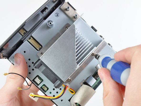

Step 14  ¶
  • After popping off the top metal cover, we find:
Image #1

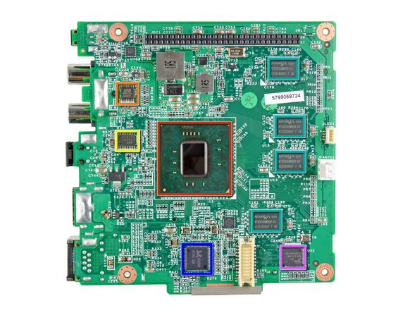

Step 15  ¶

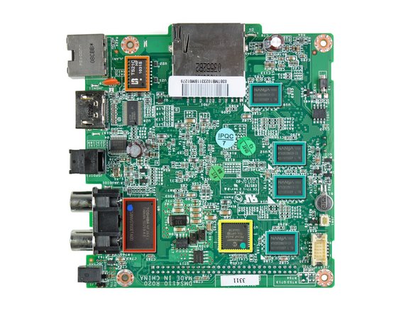

  • The other side of the motherboard:
    • Toshiba NF3662 TC58NVG3S0ETA00 1 GB NAND Flash
    • LB TS21C HF 1031S
    • Microchip PIC24FJ64GA004-I/PT 16-bit microcontroller
    • Nanya NT5CB128M8CN-CG 512 MB DDR3 SDRAM (1/2 total RAM capacity)

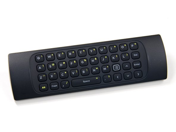

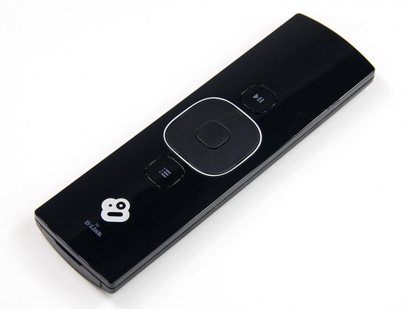

Step 16  ¶

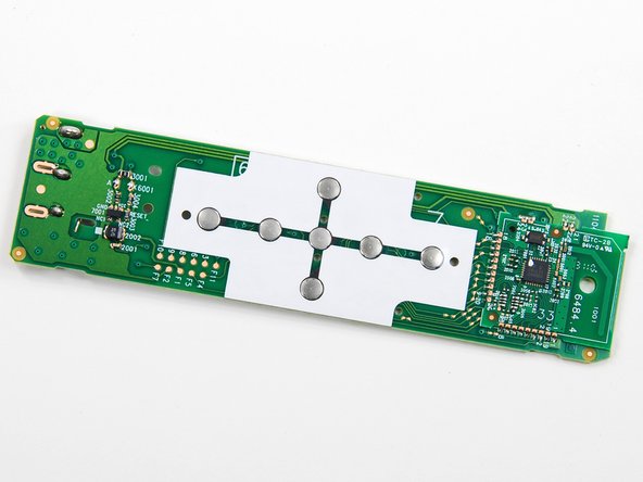

  • The Boxee Box's remote is very impressive. The front side has a basic directional pad with a select button in addition to separate play and menu buttons.
  • Instead of employing a full-sized keyboard like the Logitech Revue, Boxee Box engineers cleverly applied a mini QWERTY keyboard to the backside of the remote.
  • When we cracked the remote control open, we discovered a Nordic Semi NRF24LE1 for wireless connectivity to the Nordic Semi NRF24LU1P transceiver attached to the wireless interconnect board.
    • These are the same two chips found in the Logitech Revue's wireless transmitter and receiver circuits.
Image #1 Image #2
