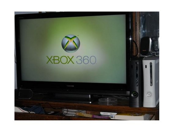

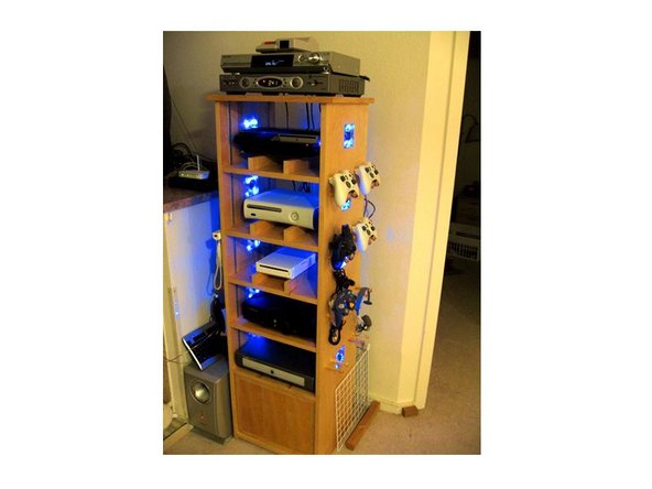

Step 1 — Xbox 360 Preventative Maintenance  ¶
  • Very nice examples here of being well ventilated.
Image #1 Image #2
Step 2  ¶
  • Don't have your system like this.
  • Avoid having other electronics such as your tv or dvd player close to the console.
