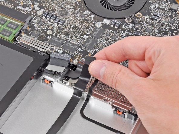

  • Remove the following four screws securing the hard drive cable assembly to the upper case:
    • Two 1.6 mm Phillips screws securing the shield that covers the hard drive cable connector.
    • Two 2.2 mm Phillips screws securing the hard drive cable connector to the upper case.
  • Remove the shield from the logic board.
Image #1

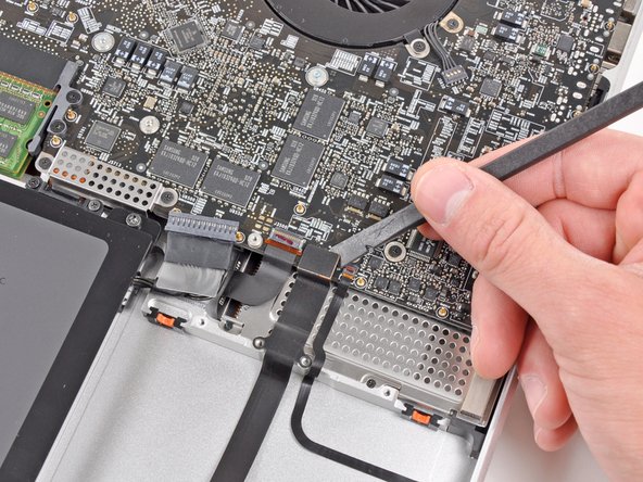

Step 2  ¶
  • Use the flat end of a spudger to pry the hard drive connector up and out of its socket on the logic board.
Image #1
Step 3  ¶
  • Lift the hard drive cable out of the upper case.
