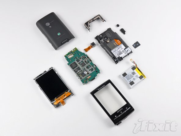

In the midst of the iPhone 4 craze, we became impatient and decided we needed to tear down a phone, you know, just to keep us in tip-top shape. And lo-and-behold, the Sony Ericsson Xperia X10 Mini E10i.
A big thanks to Brian at EDN for providing the phone for this teardown. Be sure to check out his Xperia X10 Mini Preview!

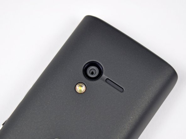

  • The backside of the X10 Mini E10i is characterized by a smooth plastic rear case with openings for the camera, LED flash, and speaker.

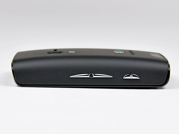

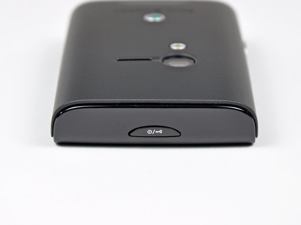

  • The controls of the X10 Mini E10i are pretty standard.
    • The bottom of the X10 Mini E10i integrates a 3.5 mm headphone jack as well as a micro-USB port.
    • The top edge houses the power button.
    • The left side accommodates the volume and camera buttons, leaving the right side blank and featureless.

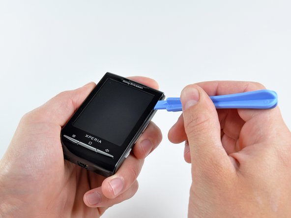

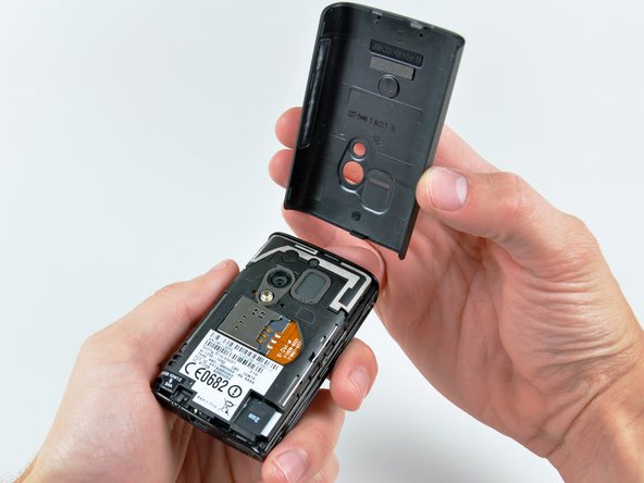

  • A few quick pries with an iPod opening tool around the perimeter of the X10 Mini E10i and the rear case easily pops off to access the phone's innards.
  • The actual electronic volume and camera buttons are attached directly to the logic board. The buttons you press on the outer case are just chrome covers.

  • A thumbnail is all that is needed to remove the microSD card from its housing in the inner case.
  • The simple design of the Mini E10 allows most components to plug directly into the logic board. The only exception is the external microSD card slot.

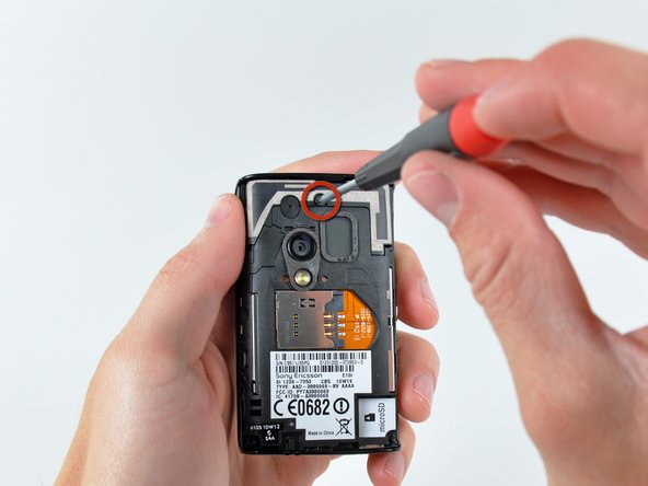

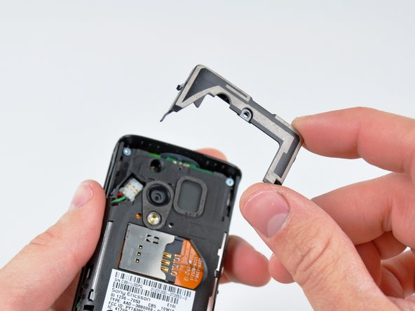

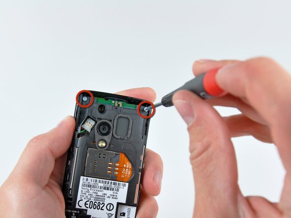

  • A single T5 Torx screw and a few plastic clips are all that secure the antenna assembly to the inner case.
  • The antenna assembly uses simple yet effective pressure contacts to make a connection with the logic board. No connectors necessary!

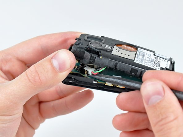

  • A couple more T5 Torx screws secure the rear inner case and logic board to the rest of the X10 Mini E10i.
  • Disconnect the battery connector from the logic board with the flat end of a spudger.
  • Pry up the SIM card socket connector and remove the rear inner case from the the logic board.

  • Big players on the board include:
    • A Qualcomm MSM7227 with 600 MHz application processing, 400 MHz modem processing, hardware accelerated 3D graphics, integrated Bluetooth 2.1 & GPS capabilities, and image/video encoding & decoding.
    • STMicroelectronics NANDCBR4N9
    • Skyworks SKY77336 GSM power amplifier module
    • Qualcomm PM7540 power management IC
    • Qualcomm RTR6285 UMTS RF transceiver with receive diversity and GPS
    • TriQuint TQM679002A WLAN Power Amplifier
