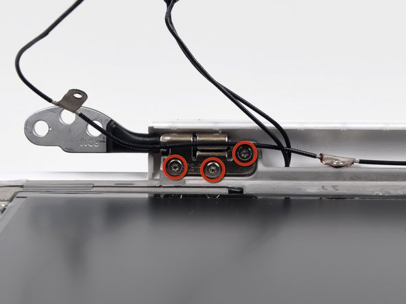

Step 1 — Right Clutch Hinge ¶
Remove the three 4.7 mm T6 Torx screws securing the right clutch hinge to the rear display bezel.

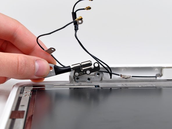

Step 2 ¶
Remove the right clutch hinge from the rear display bezel.
