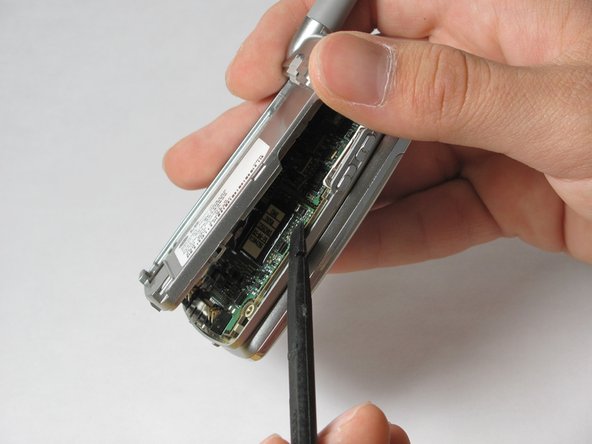

Step 1 — Logic Board  ¶
  • Use the T7 Torx screwdriver to remove the four screws that are in the cavity where the battery was.
Image #1 Image #2 Image #3

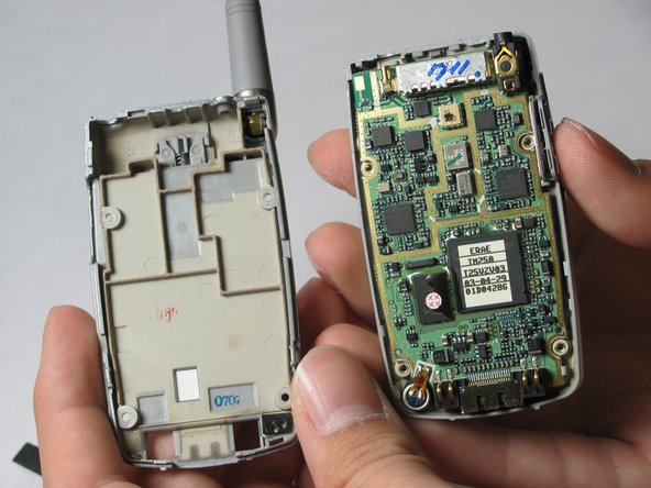

Step 2  ¶
  • Carefully wedge the spudger around the sides of the plastic casing and pry off the back side of the phone.
  • Be careful when prying off the case. The spudger can damage the phone case.

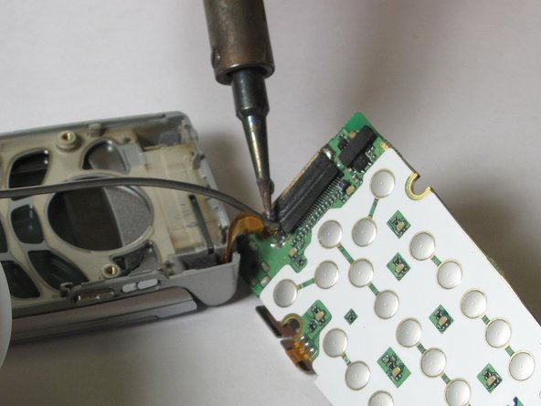

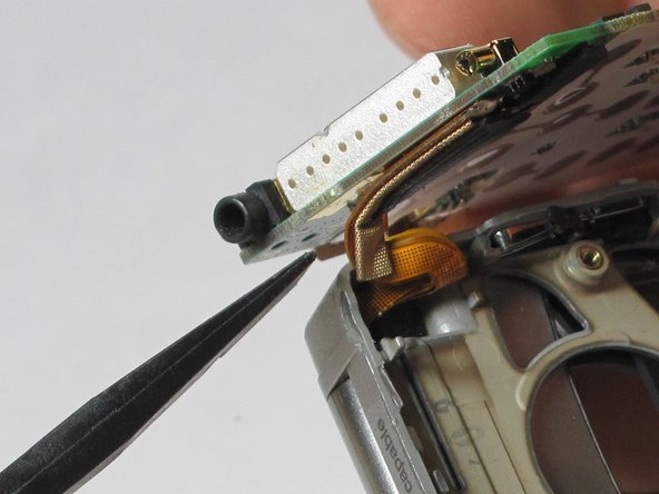

Step 3  ¶
  • Gently pry off the logic board with the spudger; notice the gold strip that connects the logic board to the rest of the phone.
  • Prying the logic board off too quickly may damage the strip.
  • Desolder the part of the gold strip that is attached to the logic board.
  • Use the spudger to carefully lift up the small latch that holds the gold strip onto the logic board.
