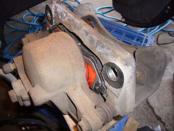

  • Don't have your work light RIGHT up against the flimsy plastic of the splash-shroud. I was back and forth from the house for tools. Came out to a burning smell. VERY funny. When THIS is the worst thing that happens in your automotive project, you're doing OK.
  • A little souvenir from the incident.
  • And a little evidence left on the car.
Image #1 Image #2 Image #3

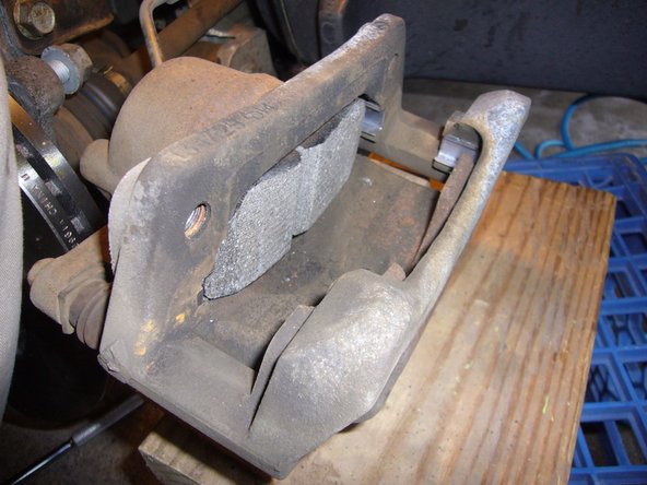

  • This is the caliper freed from the car and supported.
  • One should take off the brake fluid resevoir cap, since later we'll be pushing old pads back, and raising the overall level.
  • The cap itself says to clean it first.
  • If the fluid has been "topped off" at any time, then one will have to pay attention to overflow during later steps. If the fluid hasn't been altered since new, then there should be no worries.
Image #1

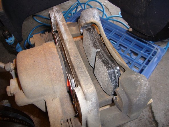

  • The old pads now come out by hand. Some jiggling may be necessary, but in my application, I didn't even have to tap them with anything. The pads sit passively in little channels, and come out towards the inside. There should be little clips remaining.
  • The new pads are thicker than the old, obviously.
Image #1 Image #2

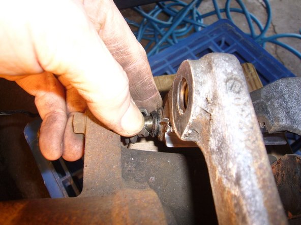

  • If the carrier can't move freely back and forth, uneven pad wear can result. The pads should come with a tiny tube of high temperature grease. Carefully ease back the boots from the slides, and grease both rails. There's 2 for each side of the car, so budget accordingly.
Image #1 Image #2

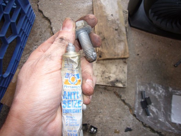

  • With the two 13/16" bolts back in, it's DONE!
  • You might choose a smidge of anti-seize on the 13/16" bolts, so that they'll come off next time.
  • The other side of the car is done the same way of course.
