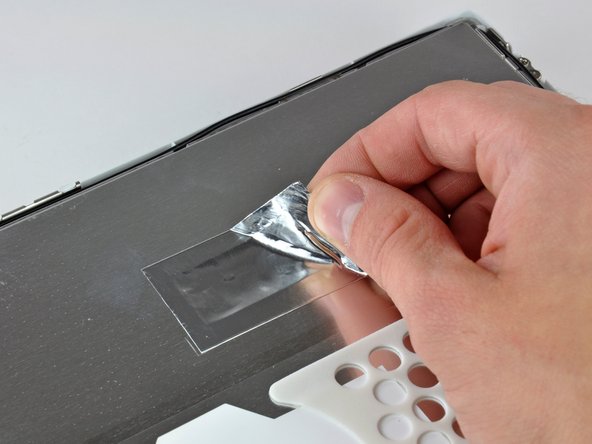

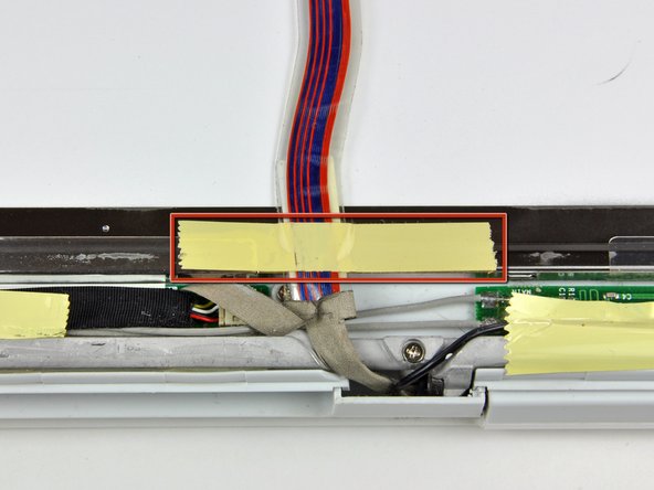

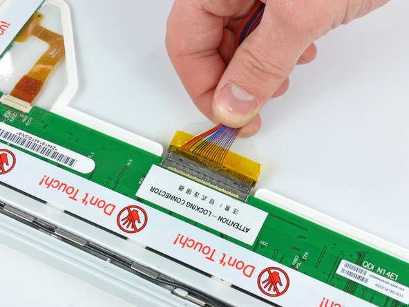

Step 1 — LCD  ¶
  • Close the display.
  • Remove the several pieces of tape securing the thin metal LCD cover to the display.
  • Carefully remove the piece of foil tape covering the display data cable connection.

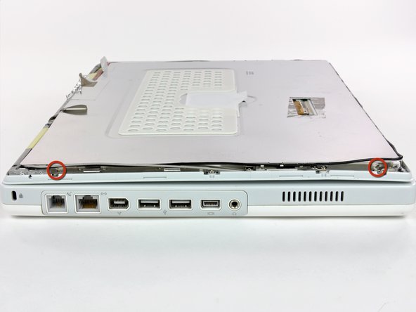

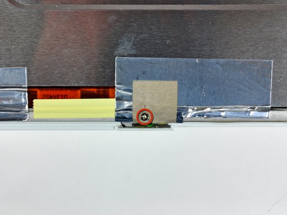

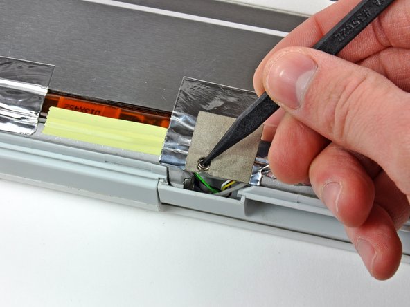

Step 2  ¶
  • Remove the Phillips screw near the right display hinge.
  • Use the tip of a spudger to remove the small spacer under the screw you just removed.

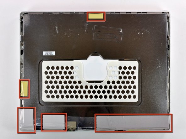

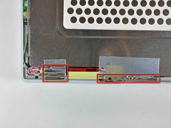

Step 3  ¶
  • Pull the foil/braided pieces of tape off the aluminum frame of the clutch hinges.
  • Leave the tape attached to the thin steel LCD cover.

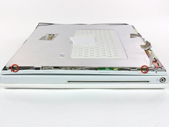

Step 4  ¶
  • Remove the two Phillips screws securing the left and right sides of the LCD to the frame of the clutch hinges (four screws total).

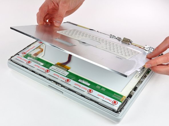

Step 5  ¶
  • Carefully remove the thin steel LCD cover.

Step 6  ¶
  • Disconnect the display data cable by pulling the cable away from the socket on the LCD.
Image #1

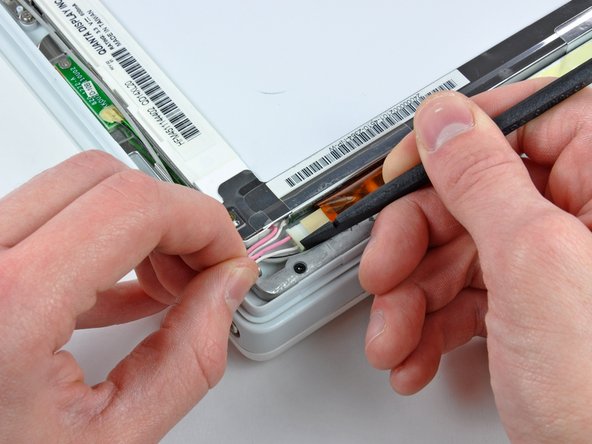

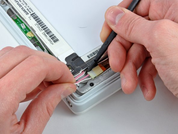

Step 8  ¶
  • Disconnect the backlight cable from the inverter.
  • It is helpful to use a spudger to push the backlight connector away from its socket while you lightly pull its cables away from the inverter.
Image #1

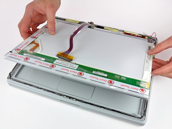

Step 9  ¶
  • Lift the LCD out of the display assembly.
  • It may be helpful to press the latch release button and open your display slightly to push the LCD out of the display assembly.
