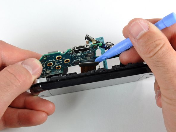

Step 9  ¶
  • After disconnecting the Select/Start button, volume buttons, and the headphone jack, the logic board simply lifts out of the case.
  • The analog joystick comes right out with the logic board.
Image #1 Image #2
