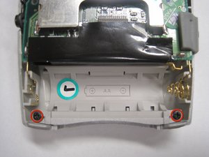

Battery Compartment
Remove the two 5.5mm screws from the sides of the battery compartment with a Phillips #00 Screwdriver.
