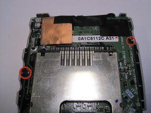

Circuit Boards
Remove the two 5.5mm screws on the left and right edges of the circuit board with a Phillips #00 Screwdriver.
