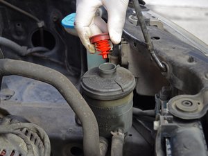

Power Steering Fluid
Locate the power steering reservoir near the front right corner of the engine bay.
If the fluid level is below the "Lower Level" fill line, remove the cap and refill the reservoir with power steering fluid.
Don't fill the reservoir so much that the fluid level goes above the "Upper Level" fill line.
