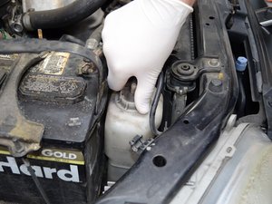

Unscrew the cap from the radiator overflow reservoir located to the left of the radiator, in front of the battery.
Fill the reservoir with water until the water level is just below the "max" fill line marked on the left side.
Replace the cap on the reservoir.
