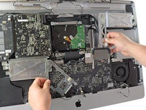

Simultaneously lift and rotate the logic board and heat sink assembly away from the iMac case until you can easily access the back side of the logic board.
