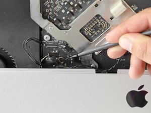

Use the flat end of the spudger to push the ambient temperature sensor connector out of its socket.
