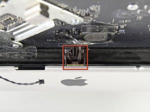

Locate the IR sensor located behind the black apple logo.
Remove the IR sensor by pulling it straight up and out of the case.
Do not attempt to completely remove the IR sensor from the case as it is still attached to the logic board.
