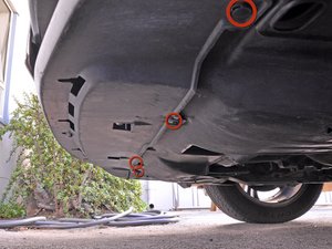

Locate the plastic push pins along the bottom of the bumper.
Use a small thin prying device, such as a flathead screwdriver, to pop the heads of the push pin up. Then remove the entire push pin assembly from their holes.
