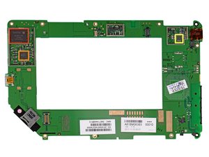

A little wiggling and out comes the picture frame motherboard. Let's see who we're dealing with:
SanDisk SDIN5C1-16G 16 GB Flash Memory
Texas Instruments 6030B107 Fully Integrated Power Management IC
Texas Instruments AIC3100 Low-Power Audio Codec With 1.3 W Stereo Class-D Speaker Amplifier
Texas Instruments LVDS83B FlatLink 10-135 MHz Transmitter
Hynix H9TKNNN8P 1 GB DDR2 RAM
This chip likely covers the Texas Instruments OMAP4 1 GHz dual-core processor, just like the Kindle Fire.
Kionix KXTF9 Tri-Axis Accelerometer
