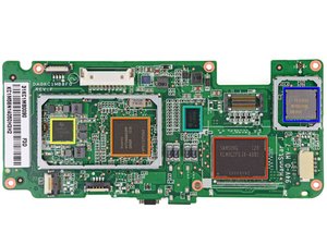

We put on our classy monocle magnifying glass to help us identify the ICs:
Samsung KLM8G2FEJA 8 GB Flash Memory
Hynix H9TKNNN4K 512 MB of Mobile DDR2 RAM
Texas Instruments 603B107 Fully Integrated Power Management IC with Switch Mode Charger
Texas Instruments LVDS83B FlatLink 10-135 MHz Transmitter
Jorjin WG7310 WLAN/BT/FM Combo Module
Texas Instruments AIC3110 Low-Power Audio Codec With 1.3W Stereo Class-D Speaker Amplifier
Texas Instruments WS245 4-Bit Dual-Supply Bus Transceiver
