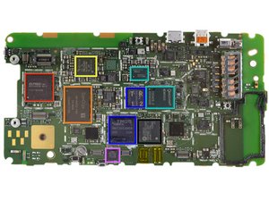

After some slash-and-burn on the EMI shield forest, we found the big players on the motherboard:
Elpida B8064B2PB-8D-F 1 GB DRAM and TI OMAP 4430 processor
SanDisk SDIN4C2-16G 16GB Flash memory
ST Ericsson CPCAP 006556001
The Qualcomm PM8028 power management chip works in conjunction with the Qualcomm MDM6600 to provide CDMA connectivity.
Hynix H8KCS0SJ0AER and Hynix H8BCS0QG0MMR memory MCP containing Hynix DRAM and STM flash
ATMEL MXT224E-CCU Touchscreen Controller
Motorola T6VP0XBG-0001, believed to be the (LCM 2.0) LTE baseband processor.
