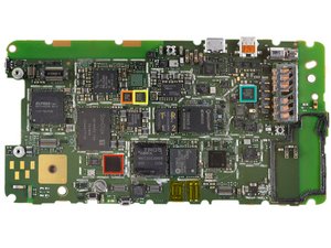

There's tons of chips on the front of the board. Other chips of interest include:
Texas Instruments WL1271 chip that supports WiFi (802.11 b/g/n), Bluetooth 2.1, FM and GPS technologies (thanks Chipworks!)
Kionix KXTF9 accelerometer
ST Micro AGD8 2040 S6NBF gyroscope
Avago ACPM-7868 quad-band power amplifier
