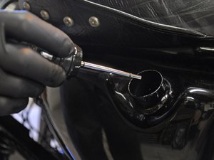

Adding New Oil
Pull the oil cap/dipstick off of the oil tank.
Some models will require the cap to be twisted first, then pulled. If you are not sure what model you have, work carefully and gently, making sure to not damage anything.
Using your funnel, slowly pour 3 quarts of oil into your oil tank.
Although the Evolution engine holds up to 3.5 quarts after a rebuild or when filled new, only 3 get replaced during the oil change.
Use the oilcap/dipstick to check your engine oil level (holding the bike level if you have been working with your side-stand). You oil level should be kept between the 2 dipstick marks. After refilling with 3 quarts it should be right to the top one.
