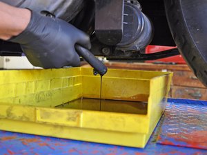

Re-installing the Drain Tube
Move the drain pan back underneath the oil drain tube. By this time more oil will have collected in it. Remove the tube again, and allow it to run out until it is just a light drip.
Reinstall the oil drain tube on its nipple, tightening the hose clamp with a flathead Screwdriver.
