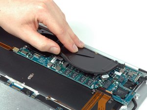

The heat sink is made of very thin aluminum and looks totally different from anything we've seen in a Mac before.
The L-shaped aluminum bracket on the heat sink rests tightly against the lower case, providing thermal conductivity without making an electrical connection to the chassis. The inside of the lower case has a patch of non-conducting material to aid this thermal dissipation.
