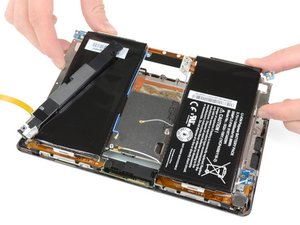

Let's remove the mid-plane board, which houses the battery, left speaker, and antennas.
This design allows for quick-and-easy access to the front panel and LCD - the most commonly broken components on mobile devices.
The actual antennas in the PlayBook are built into the rear case and speaker modules, and are attached to the antenna cables via pressure contacts.
