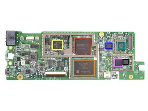

Front view of the motherboard. If you want the super-huge version of the motherboard, click here.
Elpida B8064B2PB-8D-F 1GB DRAM & the TI OMAP4430 1GHz dual-core processor
SanDisk SDIN5C2-16G 16 GB NAND Flash
Texas Instruments TWL6030 Power Management
STMicroelectronics XTV0987 5 MP mobile imaging processor
Wolfson WM8994E audio codec
Texas Instruments WL1283 GPS/WLAN/Bluetooth/FM
TriQuint Semiconductor TQP6M9002 802.11a/b/g/n + BT front-end module
