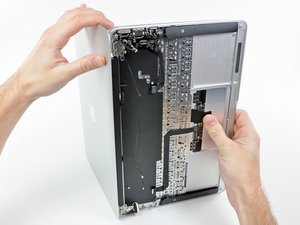

Push the upper case slightly toward the display assembly, then rotate it away from the front of the display assembly.
Once the two display hinges have cleared the upper case, remove the display and set it aside.
Keep track of the shims under each of the two display brackets. When installing the display, be sure a shim is installed under each display bracket (against the upper case) as shown in the third picture.
