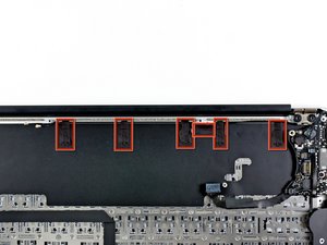

Peel up the six cable loops securing the antenna cables to the upper case.
Gently pull the cable loops slightly out of the channel cut into the upper case one at a time.
Use your spudger to open up the plastic loops as you de-route the antenna cables through them.
Repeat this for all five retaining loops.
