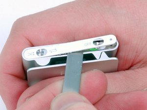

The back of the Shuffle says: Model No.:A1204 EMC No.: 2125 5V 1A.
Let's take it apart!
The top and bottom of the shuffle have white plastic caps held on by mild adhesive. Heat the caps with a hair dryer and gently pry them both up. Make sure you don't pry the metal beneath the caps up at the same time.
